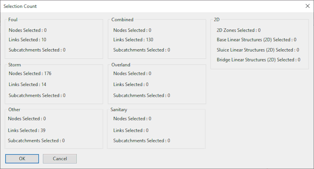

Selection Count Dialog
For InfoWorks networks, this dialog shows the number of nodes, links and subcatchments included in the current selection for each system type. If the network includes 2D objects, the number of 2D zones and base, bridge and sluice linear structures included in the current selection, will also be displayed.
For SWMM networks, this dialog shows the number of nodes, links, subcatchments and points included in the current selection.
The dialog is displayed when Selection operations | Count selected objects is chosen from the Selection menu .
