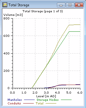

Storage Graph
Select the Generate storage graph option on the Total Storage Dialog to plot a graph of storage against height above datum for the network / selection. (This option is only available if the network is writable).
The storage analysis will calculate the total storage at 100 intervals between the lowest height of storage in the network / selection and the upper limit specified in the Total Storage Dialog. The results of the analysis are used to plot a total storage curve and subsidiary curves showing the relative contributions of manholes, manhole additional storage, storage nodes and links.
If the Also calculate live and dead storage option has also been checked, live and dead storage traces are included as two additional pages to the graph. Use the PAGE UP and PAGE DOWN keys to scroll through the pages.
Hold the cursor tool over a curve to view the value at the cursor.
