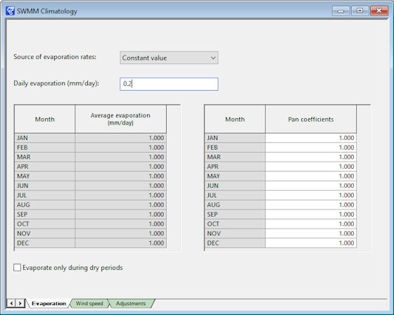

Evaporation tab on the Climatology  Editor (SWMM)
Climatology Editor - Evaporation tab
The Editor is divided into the following pages:
Evaporation
This page is used to specify the source of the evaporation rates and to define the monthly average evaporation rates where applicable, and to determine whether or not that evaporation can only occur during periods with no precipitation.
The items contained in this page are described in the following table:
Item Description
Source of evaporation rates
Specifies the type of data to be used for evaporation. The following choices are available:
  • Constant value - A constant evaporation value will be applied for all months.
  • Monthly averages - Sets individual evaporation rates for each month.
  • Calculated - Uses the Hargreaves method to calculate evaporation based on the daily temperatures contained in the applicable rainfall event. Not currently implemented in InfoWorks ICM.
Daily evaporation
Enabled when the Source of evaporation rates is set to Constant value.
Determines the evaporation value which is to be applied for all months. Default is 0.2 mm per day.
Month / Average evaporation grid
The Average evaporation column is enabled when the Source of evaporation rates is set to Monthly averages and is used to specify the average evaporation rate for each month. Default is 1 mm per day.
This grid is read-only when Source of evaporation rates is set to Constant value or Calculated.
Month / Pan coefficient grid
A set of monthly pan coefficients which are used to convert the pan evaporation data to free water-surface values. Default is 1.
Evaporate only during dry periods
A check in the box indicates that evaporation can only occur during periods with no precipitation.
Unchecked by default.
