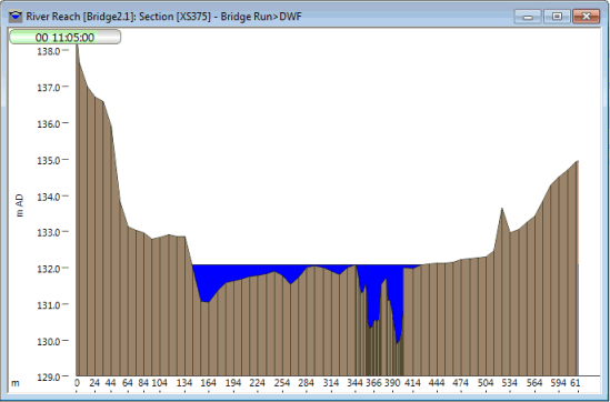

Example of Cross Section Window view when results are open on the GeoPlan

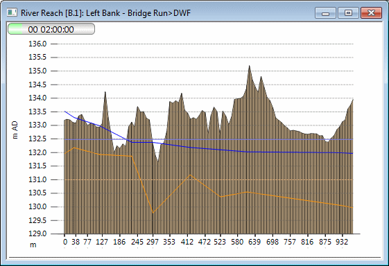

When displaying a cross section for a river reach bank, traces are displayed representing water levels and ground levels inside and outside of the reach.
The inside level traces represent water and ground levels inside the river reach. The traces are drawn by plotting the levels for the sections defined as bank section markers. Ground levels are plotted as the lowest ground level at each section marker.
The outside level traces represent water and ground levels in a connected structure on the other side of the river reach bank. The connected structure may be a storage node, 2D zone or another river reach. (See River Reach Building Tools for further information on building bank connections.)
If a breach has been modelled along the river reach bank, a trace of time varying bank level is also displayed. The trace represents the bank level as it changes over time based on the RTC definitions used to control movement of the bank points when modelling a breach. The varying bank level trace may not match the fixed bank level trace exactly, as levels are adjusted during simulation to ensure that points are not set below the elevation of objects that the bank abuts. See Breaches in Banks and Linear Structures for details.
