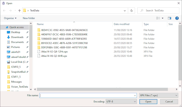

  1. Open the InfoWorks network to be updated.
  2. Select ImportModelfrom XPRAFTS XPX file from the Network menu, and a standard Windows Open dialog is displayed.
  3. Select the .xpx file to be imported.
  4. From the Encoding dropdown list, select which encoding system is used in the xpx file to be imported. Currently supported systems are ANSI, UTF-8 (default) and UTF-8 BOM.
  5. Click Open. The import process starts and an XPRAFTS Import dialog is displayed.
