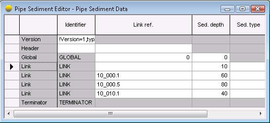

Pipe Sediment Editor
The Pipe Sediment Editor is used to enter and edit Pipe Sediment Data. Pipe sediment data can be used to override values for Sediment Depth set in the conduit parameters.
The pipe sediment data consists of a Global record and zero or more Link records. These records are bounded by a Header and a Terminator record. The Global record sets a default Sediment Depth for any links that do not have specific depths defined. Link records define a specific Sediment Depth for an individual link.
All operations on the grid can be carried out from the popup menu displayed by right clicking on the editor.

Global
The Global Record defines the default sediment depth for the network.
There must be one Global record.
Sediment Depth
The default sediment depth (in mm), which will be applied to all pipes for which no individual depth is specified in the Link records.
If this value is left blank, the simulation engine will assume a depth of zero. It will not use the Sediment Depth value from the conduit parameters

Link
The Link Record defines the sediment depth for a particular pipe.
Any number of Link records can be added. Link records do not have to be included for any individual pipes that do not have any data. In this case the default sediment depth will be applied.
