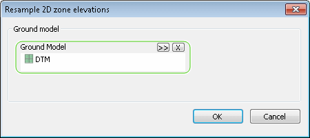

Resample 2D Zone Elevations Dialog
This dialog is used when recalculating ground elevations of existing 2D mesh elements within selected 2D zones. It is displayed by selecting MeshingResample 2D zone elevations from the Model menu.
Select the ground model from which elevations are to be sampled and click OK. New ground levels for mesh elements are calculated by sampling the ground model selected in the dialog.
