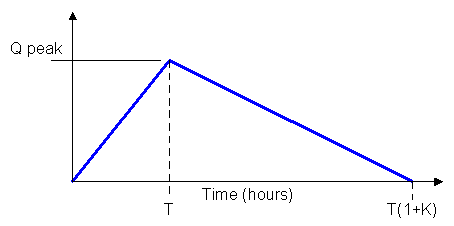

Each set of RTK parameters defines a triangular graph against time, where:
Three sets of RTK parameters can be defined, representing short-term, medium-term and long-term rainfall response. The three triangular graphs are combined to define the Unit Hydrograph.
