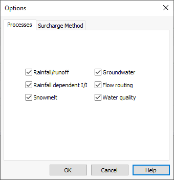

Processes tab in the Options dialog
Processes Page
Rainfall/runoff
A check in the box indicates that the rainfall/ routing process is to be simulated. Checked by default.
Rainfall dependent I/I
A check in the box indicates that rainfall dependent infiltration / inflows are to be simulated. Checked by default.
Snowmelt
A check in the box indicates that snowmelt is to be simulated. Checked by default.
Groundwater
A check in the box indicates that any percolation of infiltrated water into groundwater layers are to be simulated. Checked by default.
Flow routing A check in the box indicates that flow routing is to be simulated. Checked by default.
Water quality A check in the box indicates that water quality is to be simulated. Checked by default.
