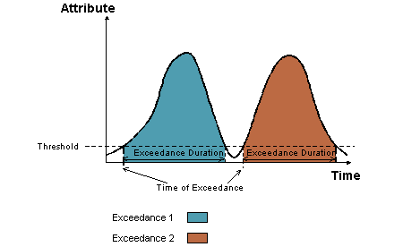

Start of exceedance (mins)
Start of exceedance (Absolute)
Exceedance duration (mins)
Time of exceedance (mins) is the number of minutes into the simulation at which the exceedance starts, where the simulation uses relative time.
Time of exceedance (Absolute) is the date and time at which the exceedance starts, where the simulation uses absolute time.
Exceedance duration is the length of the exceedance.

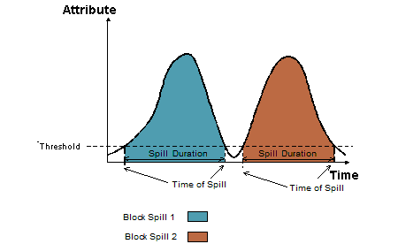

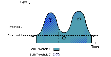

Start of spill (mins)
Start of spill (Absolute)
Spill duration (mins)
Time of spill (mins) is the number of minutes into the simulation at which the block spillage starts, where the simulation uses relative time.
Time of Spill (Absolute) is the date and time at which the block spillage starts, where the simulation uses absolute time.
Spill duration is the length of the block spillage.

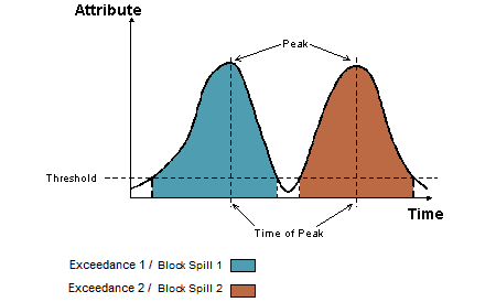

Peak <attribute>
Time of peak (mins)
Time of peak (absolute)
Peak is the maximum value during the exceedance or maximum flow during the block spillage.
Time of peak is the time at which the exceedance maximum or block spillage maximum occurs.
Spill volume The volume of spillage during the block spill duration.
Exceedance integral
Area under Attribute vs Time graph for individual exceedance.

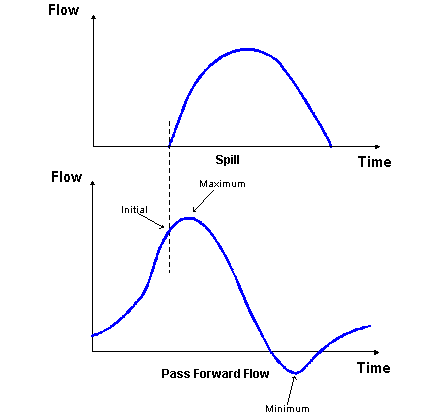

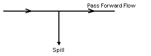

Pass forward link
Initial pass forward flow
Minimum pass forward flow
Maximum pass forward flow
The Pass forward link is the link specified in the Statistics Template grid.
The initial, minimum and maximum pass forward flows are identified as shown in the example below:

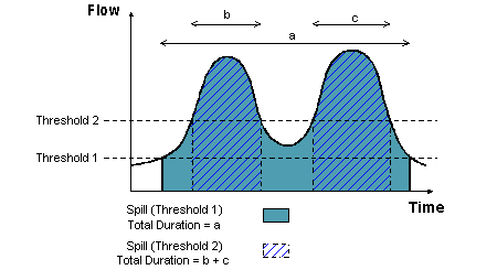

Total period of exceedances
Sum of the time between the overall first and last times of spillage (threshold exceeded) within all the block spillages.
Note that this is usually a larger value than the Total duration of exceedances as that corresponds to the total spillage time (i.e. sum of all durations where the threshold is exceeded) within all the spill blocks.
Sum of duration of Exceedances or block spillages over Threshold that occur during the simulation.

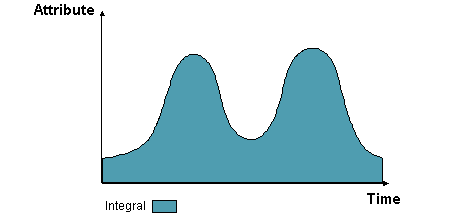

Total integral
Sum of exceedance areas under Attribute vs Time graph.

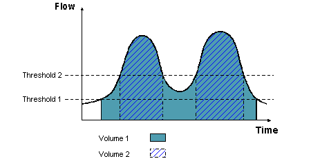

Click on the image below to display an example of the sum of spill volumes throughout simulation.
