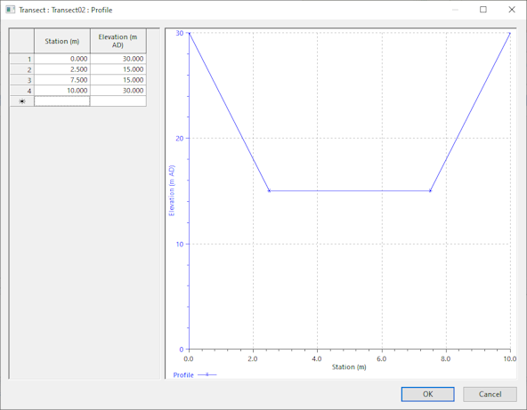

The Transect Editor is displayed when the button is selected in the Profile field in a Transect, and is used to specify the station (the distance from the left bank) and the elevation values which define the cross section of a custom shape type of conduit. The specified values will appear as the cross section profile in the graph.

The station and elevation values entered in the grid will appear as the cross section profile in the graph.

OK Saves any changes to the values in the grid and closes the editor.
Cancel Discards any changes to the grid values and closes the editor.
