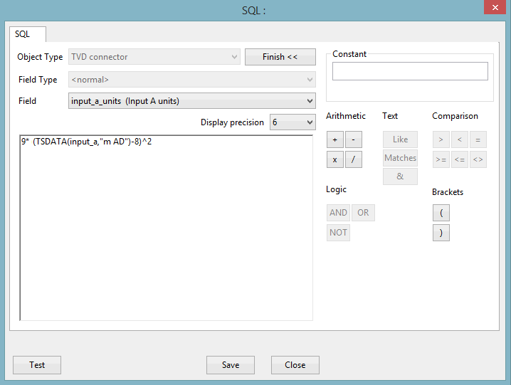

TVD Connector - SQL Expression Dialog
This dialog is a simplified version of the standard Innovyze SQL dialog and it enables you build an SQL expression for a TVD connector.
Note: TVD connectors are not currently used in simulations for cloud databases.
The expression can be checked using the Test button in the dialog. If the expression is valid, the results from evaluating the expression are displayed; but if not, a suitable warning will be issued.
A saved expression is automatically evaluated during an appropriate Run.
The SQL Expression dialog is displayed when you click in the Output expression field in the TVD Connector Grid Window of the Polygons Grid or a TVD Connector's Property Sheet.
Show me
If you are familiar with SQL syntax, you can type in an expression manually (using the Field drop-down list, if required, to insert the fields you want to include in the expression). The supported SQL operators and functions, which can be used in an expression, are listed below.
Alternatively, click Builder >> . This displays a set of buttons representing the operators that you can include in the expression.

Builder
Click the Builder >> button to display a set of buttons representing the operators that can be included in the expression. Click the Finish << button to close the builder.
Test
Tests that the expression contains valid SQL functions and operators. See Testing the expression for further information.
Save
Saves the current expression. The saved expression is displayed in the Output expression field in the TVD Connector's property sheet or grid window.
Close
Closes the SQL Expression dialog without saving the expression.
