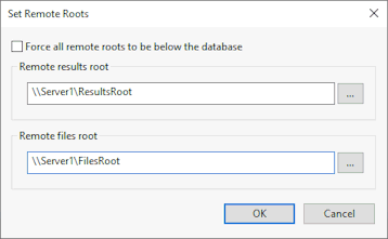

Set Remote Roots Dialog
This dialog is used to set the directories to which data saved outside of the on-premise database will be written.
It is displayed when you select the Database managementSet remote roots option from the File menu.
See Remote Roots for further information.
Dialog description
Item
Description
Force all remote roots to be below the database
Available for Standalone databases only.
Check this box to store all remote root data in the folder containing the database.
Remote results root
InfoWorks ICM simulation results saved to the server will be stored in the remote results root.
Enter the path of the folder to be used as the remote results Root or use to browse for a folder.
Remote files root
If background map layer files or hyperlinked files are stored in the remote files root; Layer List and hyperlinked file paths will be stored relative to the remote files root.
Enter the path of the folder to be used as the Remote Files Root or use to browse for a folder.
