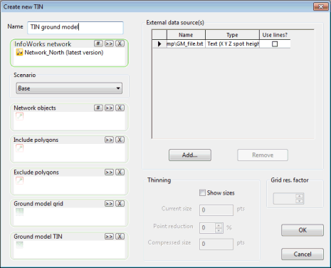

Create New TIN Ground Model Dialog
This dialog is used when creating a TIN ground model from other data.
It is displayed when you right-click on a Model group and choose New InfoWorksGround model TIN or New SWMMGround model TIN from the popup menu.
Dialog description
Item Description
Name Name of the TIN ground model to be created.
InfoWorks network
SWMM network
Used when creating a TIN ground model in conjunction with Scenario and:
  • Network objects to include a selection of cross section lines, bank lines and / or river reaches (InfoWorks network only)
  • Include polygons / Exclude polygons to include / exclude a selection of points
A box in which the relevant type of network, that includes the selected objects, can be dropped.
The title of the box is determined by which option (New InfoWorksGround model TIN or New SWMMGround model TIN ) the dialog is invoked from.
Scenario
Dropdown list of scenarios available for the selected InfoWorks network or SWMM network. Select the scenario containing objects in Network Objects and Include polygons / Exclude polygons selection lists.
Network objects
Used to include a selection of network objects in an InfoWorks or a SWMM network, and for InfoWorks networks only; general points, cross section lines, bank lines and river reaches when creating a TIN ground model.
Elevation data of selected points, lines and / or river reach section and bank profiles will be used to create new TIN vertices. Lines and sections will be treated as break lines during the creation process.
Include polygons
Used in conjunction with the InfoWorks network or SWMM network to define areas to be included when creating a TIN ground model.
Only points within the general polygons defined in the selected network will be used when creating the new TIN. The polygon defines the ground model boundary.
Exclude polygons
Used in conjunction with the InfoWorks network or SWMM network to define areas to be excluded when creating a TIN ground model.
Points within the general polygons defined in the selected network will not be used when creating the new TIN.
Ground Model Grid
Used when creating a TIN Ground Model from an existing Grid Ground Model.
Existing ground model from which new TIN is to be created.
Ground Model TIN
Used when creating a TIN Ground Model from an existing TIN.
External data source(s)
Used when creating a TIN Ground Model from external data.
Name - path of external data file
Type - type of external data file
Use lines? - enforce polylines as TIN edges
Thinning
Used when Thinning a TIN Ground Model.
Check the Show sizes box to enable the thinning options.
Current Size - displays the number of points contained in the existing ground model
Point Reduction - adjust percentage to set how much smaller the new ground model will be
Compressed Size. - an estimate of the number of points in the new ground model
Grid res. factor
Used when converting a Grid Ground Model to a TIN
The grid resolution factor is used to lower the resolution of the TIN ground model, where the Grid Res. Factor x Grid Base Cell size corresponds to the minimum size to be considered when importing values from the Grid ground model.
See Creating a TIN Ground Model for further information.
