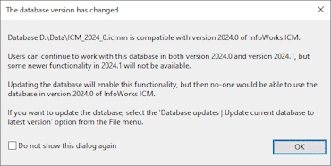

Database Version Change Dialog
This dialog is displayed when you install a new version of InfoWorks ICM. It informs you that the version for the current on-premise or cloud database can be changed and the implications of updating it to the latest version.
It contains a Do not show this dialog again check box. If unchecked (default), this dialog is displayed every time you open this database.
If checked, the dialog will not be displayed again.
All updates to SQL Server or Oracle databases must be carried out manually using SQL scripts. You will see a different dialog in this case.
