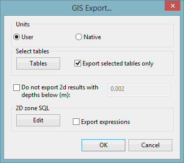

This dialog is used when exporting networks , simulation results, risk analysis simulation results or risk analysis result objects to one of the following GIS formats:
GIS Export (exporting from a network)
GIS Export (exporting simulation results (InfoWorks networks only))
Dialog description

Units Export using InfoWorks ICM Native Units / current User Units

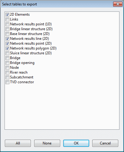

Select tables
If checked, export is restricted to a selection of tables.
The tables to be exported can be selected when you click Tables. This displays the Select tables to export dialog.
Check the boxes next to the tables to be exported. Use the All and None buttons to select or deselect all tables in the list.
Do not export 2d results with depths below
InfoWorks networks only.
Displayed when exporting results only.
Restrict the export of 2D mesh elements to those with depth greater than or equal to the value specified.
2D zone SQL
Check the Export expressions option to include export of SQL expressions for 2D zone mesh elements.
To create and edit SQL expressions for export, click Edit to display the Edit Expressions dialog.
