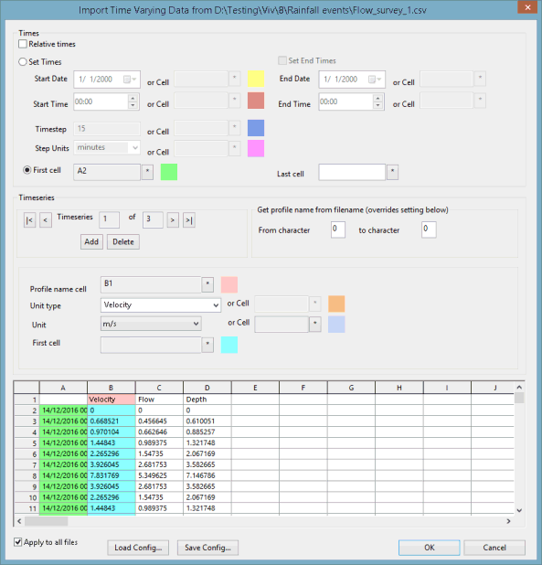

Import Time Varying Data from CSV Dialog
This dialog is a generic importer for time varying data. You can identify a column containing time information, or set a start time and timestep for the data. For each column of time varying data a unit type can be set.
The dialog is displayed if you right-click a:
Dialog description
Item Description
Relative times
If checked, relative date and times will be used for the imported data. By default, this option is unchecked.
The following relative date /time formats are currently permitted:
  • the existing number
  • hh:mm:ss For example, 24:00:00 (hh can be greater than 23)
  • hh:mm For example, 19:15 (hh can be greater than 23)
  • n hh:mm:ss or nn hh:mm:ss or n hh:mm or nn hh:mm (where n is number of days, maximum is 99). For example, 15 19:15:36 (hh cannot be greater than 23)
  • DD/MM/YYYY or MM/DD/YYYY or YYYY/MM/DD (where MM and YYYY must be all zeros), followed by a space, followed by hh:mm or hh:mm:ss For example, 15/00/0000 19:15:36 (hh cannot be greater than 23)
Set Times
Used when importing files with no date-time column to specify the time range of data to be imported and the time interval between data values. It is also used to specify timestep and timesep units when using Relative times.
The fields can be manually edited by entering data directly. Alternatively, click on a cell in the grid at the bottom of the dialog and then on the * button next to the Cell field to add the current grid cell to the Cell field.

Timestep
Interval between data readings.
Step Units
Units of timestep interval.
First Cell
Can be used if the file to be imported contains a date-time column.
In the grid at the bottom of the dialog: click on the first cell containing valid date-time information and then on the * button next to the First cell field to add the current grid cell to the First cell field.

Use the Timeseries section to view and edit parameters for each data series in the file, which are displayed in the grid at the bottom of the dialog.
Use the arrow buttons to scroll between each data series.
Data series can be added or deleted for import purposes (the underlying file will not be edited).
Data Series parameters
Describes the data type of the currently viewed data series and the location in the file where the data starts.
Field
Description
Profile cell name
InfoWorks ICM uses the contents of the cell above the first value in a data column as the profile name in the event. If you want to use the different cell, then select the appropriate cell in the grid at the bottom of the dialog containing the identifier and click on the * button.
Note: The selected profile cell name will be overwritten if the Get profile name from file is specified.
Event Type
Type of data recorded
Unit
Unit of measurement
First Cell
Cell containing first valid time series value.
In the grid at the bottom of the dialog: click on the first cell containing valid data values and then on the * button next to the First cell field to add the current grid cell to the First cell field.
Grid Window The file being imported is displayed in the grid window.
Apply to all files
Applies the current dialog settings to all files when importing a selection of multiple files.
If this option is unchecked, the import dialog will be displayed before the import of each file.
Note: When importing rainfall events, this option is only available if you have chosen the ImportRainfall eventfrom multiple generic CSV files into one event option from the popup menu.
Load Config
Loads previously saved settings from a .cfg file.
Save Config
Saves the current dialog settings to a configuration (.cfg) file.
