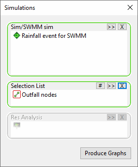

Selection list box
The Item Selection Box has a special case for Selection Lists. There is an additional Current button. Click this button to select the current selection in the current active network.
The Selection List box is used on many dialogs. An example is shown below.
Example of Selection List boxes in InfoWorks ICM
