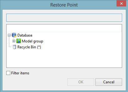

A message is displayed if you attempt to restore an item whose parent has either been permanently deleted or is currently in the recycle bin but is not selected to be restored. Click on OK and a new window is displayed enabling you to choose a different restore location.
Select the required location from the available options and click OK to restore the item to the selected location. Both the current item and any subsequent orphaned items with missing parents of the same type will be restored to the selected restore point.
