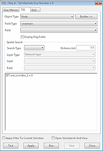

First we set the user field value in all nodes to zero.
Before doing this, make sure the field you use doesn't contain useful information!

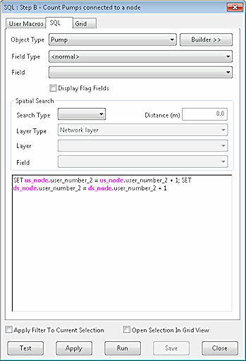

Now we count all the connections to pump objects. Note that the Object Type field for this query is set to Pump.
  • in the SQL box there are actually two SQL queries separated by a semi-colon
  • the us_node.user_number_2 syntax allows you to access data fields for the node upstream (and downstream) of the current object. This is a very useful tool
  • the two SQL queries add one to the user number fields of the connected nodes to indicate that they are connected to a pump

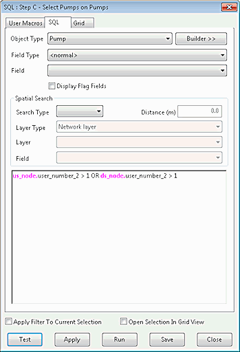

Next find all the pumps that are connected to other pumps. These will now be selected.

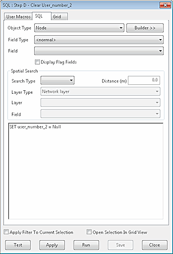

Finally, delete the count from the User Number 2 fields as we do not need it any more.
