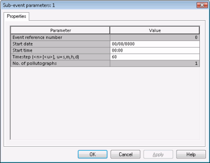

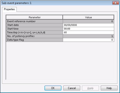

Pollutograph
This section is only relevant to Water Quality Simulations.
There are slight differences between the dialog displayed for attached pollutants and the dissolved or sediment fraction dialog. These differences are just cosmetic.
Dissolved pollutant and sediment fraction dialog.
Attached pollutant dialog.
The Data Type Flag field for attached pollutants can be ignored. The other Pollutograph Event properties are described in the Common Properties table at the top of the page.
