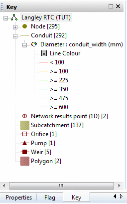

Thematic Key Window
The Thematic Key window can be used to:
The keys are displayed in a tree structure. Use the and buttons to move around the tree.
Tip: A count of the number of each type of object in the network is shown in brackets next to the object symbol.
