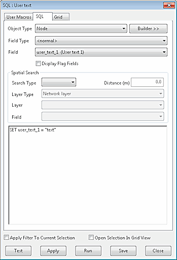

Updating the Current Object Type
The SET keyword can be used on its own or in conjunction with a WHEREsub-clause to update the current object type chosen in the Object type field of the SQL Dialog.
The syntax is as follows:
Using the SET Keyword
SET <assignment>
e.g.
SET user_text_1 = "text"
Sets user_text_1 field to text for all objects of the chosen object type (selected in the Object Type field of the SQL dialog).
SET user_text_1 = "text", user_number_1 = x
Sets user_text_1 field to text and user_number_1 field to the value in the x field for all objects of the chosen object type.

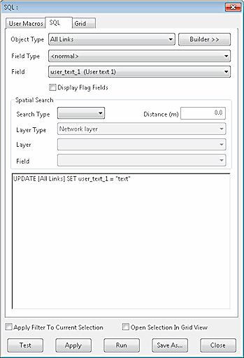

Updating a Different Object Type
The UPDATE keyword is used in conjunction with the SET and WHERE keywords to update objects of one or more types; not necessarily the type selected in the Object type list on the SQL Dialog.
Separate multiple assignments in the same statement by commas and separate multiple statements by semicolon as described in the Updating the Current Object Type section above.
Click on the images to reveal the examples.
Example 1 Example
UPDATE <object type> SET <assignment>
e.g.
UPDATE [All Links] SET user_text_1 = "text"
Sets user_text_1 field to text for all link objects.
