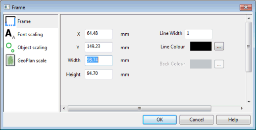

Frame Properties
Frame properties can be customised for all data frame types.
Property Description
X Horizontal position of top left corner of frame with respect to top left corner of the page frame
Y Vertical position of top left corner of frame with respect to top left corner of the page frame
Width Width of frame
Height Height of frame
Line Width Width of frame border
Line Colour Colour of frame border
Back Colour Background colour of frame

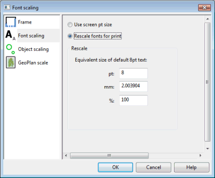

Font Scaling Properties
Font scaling properties can be customised for the following frame types:
Use screen pt size Display text in the frame at font size shown in the GeoPlan / Long Section window.
Rescale fonts for print Manually set a text scaling value by entering the equivalent size for the default font size of 8pt.

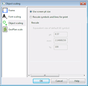

Object Scaling Properties
Object scaling properties can be customised for the following frame types:
Use screen pt size Display network object symbols and lines at the size shown in the GeoPlan / Long Section window.
Rescale symbols and lines for print Manually set a symbols and lines scaling value by entering the equivalent size for the default symbol size setting of 60.

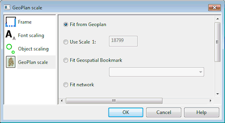

GeoPlan Scale Properties
GeoPlan scale properties can be customised for the following frame types:
Fit from geoplan Scale contents of GeoPlan frame so that what is displayed on the GeoPlan is displayed in the frame.
Use Scale 1: Manually set a magnification scale for display of GeoPlan contents.
Fit Geospatial Bookmark
Scale contents of GeoPlan frame so that the view defined by the bookmark selected in the dropdown is displayed in the frame.
The dropdown lists all bookmarks for the network currently displayed in the GeoPlan frame.
Fit network Scale contents of GeoPlan frame so the entire network is displayed in the frame.

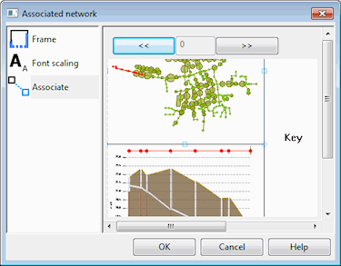

Associate Properties
Associate properties apply to the following frame types:
Some frames require an associated frame in order to be displayed:
To set the association, click on the frame that the current frame is linked to. The arrows at the top of the properties dialog can be used to scroll between print layout template pages.

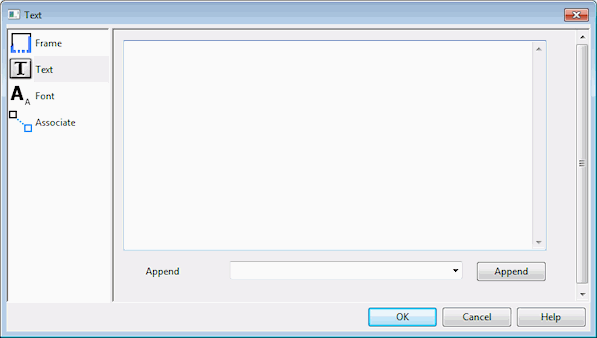

Text Properties
Text properties are applicable to Text frame types only.
Show me
Text box Enter text to be displayed in the text frame
Append
The Append dropdown contains a list of variables that may be included in the text frame. For example, #{networkname} can be used to display the name of the network currently displayed in the associated GeoPlan frame.
Select a variable from the dropdown list and click the Append button to add the variable to the end of the text entered in the text box.

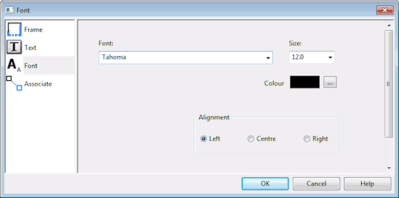

Font Properties
Font properties can be customised for the following frame types:
Font Select font style from the dropdown list
Size Set size of font
Colour Click the ... button to display a colour picker to set font colour
Alignment Select position that font is to be displayed at.

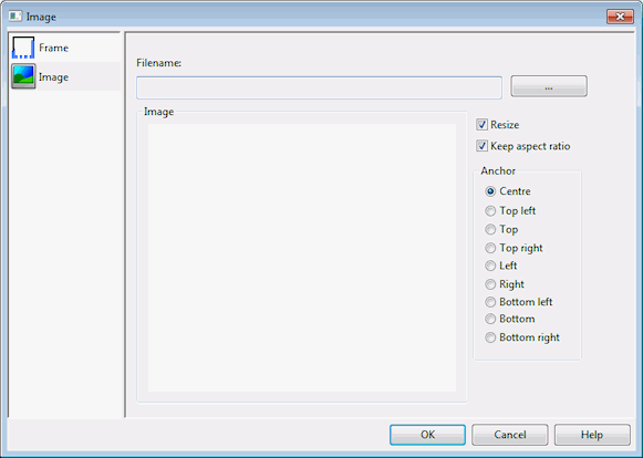

Image Properties
Image properties are applicable to Image frame types only.
Filename
Click the ... button to display a Windows File Open dialog.
Browse for an image file to be included in the image frame.
Image Displays a preview of the selected image file
Resize Check the Resize option to resize the image to fit the image frame
Keep aspect ratio
When resizing image, maintain the proportional relationship between width and height.
If this option is turned off and the image is resized, the image will be resized to fill the image frame.
Anchor Select the position in the image frame that the image will be anchored to.

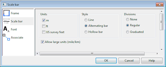

Scale Bar Properties
Scale bar properties are applicable to Scale frame types only.
Units Select which units to display on the scale bar
Style Select an option to control the style of the scale bar
Divisions
Select an option to control the number of divisions displayed along the scale bar:
  • None - tick marks are only displayed at the end of the scale bar
  • Regular - tick marks are displayed at regular intervals along the scale bar
  • Graduated - tick marks are displayed at smaller intervals at the start of the scale bar
Allow large units Allow units to be displayed in miles or km if scale units are large

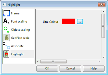

Highlight Properties
Highlight properties are applicable to Locator frame types only.
Select a colour from the colour picker for the border of the locator box.

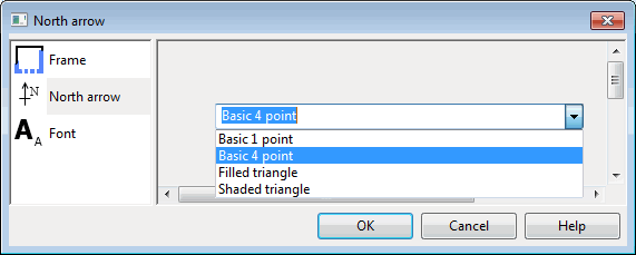

North Arrow Properties
North arrow properties are applicable to North frame types only.
Select an arrow type from the dropdown list.
