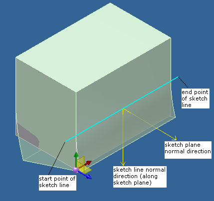

| BendSide | PartFeatureExtentDirectionEnum | Input constant that indicates which side of the model to bend. The bend side is specified with respect to the input bend line (sketch line), i.e. whether the model to the left, right or both sides of the bend line should be bent. The left side is the natural normal direction at any point on the sketch line (the cross-product of the vector representing the direction of the sketch line and the vector representing the sketch normal). The right side refers to the direction opposite to that of the natural normal. The following figure demonstrates an example of how the bend side is determined based on the normal direction of the sketch line. ![]() The figure represents a model in which a sketch plane has been drawn on the rectangular side face. The sketch plane consists of a single sketch line which represents the bend line. The sketch plane normal direction is perpendicular to the face and coming out of the model. The direction of the sketch line which can be inferred from the start point and end points of the sketch line is towards the right. Therefore, the normal vector at any point on the sketch line is pointing in the downward direction (imagine standing on the normal side of the sketch plane and viewing in the direction of the sketch line, the normal of the sketch line will be towards your right). For the bend part feature, the left side of the bend corresponds to this normal direction of the sketch line. As indicated by the preview in the figure, when the left side is specified, the model in the normal direction of the sketch line is selected for the bend. The valid input is one of the constants in PartFeatureExtentDirectionEnum: kNegativeExtentDirection, kPositiveExtentDirection or kSymmetricExtentDirection.
