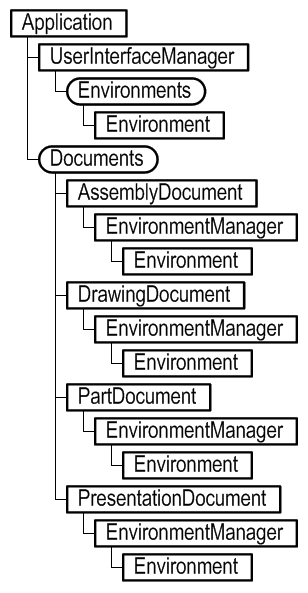

Every document has a built-in base environment. A client application may create a new custom environment by adding to the Environments collection, and will typically copy some components used in another environment, such as command bars, to the new one. Command bars can inherit their properties from the parent environment if the InheritAll property of the CommandBarList is set to true.

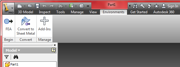

The samples that follow show how to add new environments to Autodesk Inventor. The figure below shows the initial view of the Applications menu and the panel bar, with no additional environments or edit targets added. The example code will add three new environments. Lastly, it will create an edit target within one of these environments.

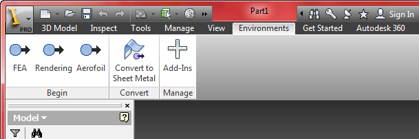

The preceding code will add the new FEA, Rendering and Aerofoil environments to Autodesk Inventor's Applications menu, as shown below. Each environment has its own set of command bars, but so far none has a specific edit target defined.

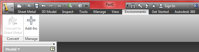

Now to add an edit target to one of these new environments. This indicates a specific editing requirement. An example in Autodesk Inventor is the sketch editing facility within the Part environment. The code is much the same as previously except now the SetCurrentEnvironment method of the EnvironmentManager object is used - this sets the environment for this document but it is not persisted.

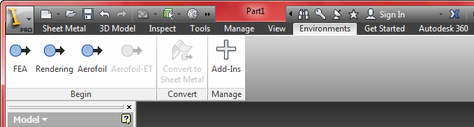

The result of this code is indicated in the following figure. Note that the Applications menu now has the new Aerofoil-ET edit target checked instead of the Part edit target. Note too the change to the panel bar.
