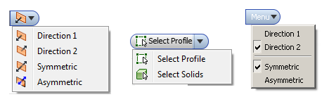

| IsSplitButton |
Read-write property that specifies if this is a split button dropdown control. If True, clicking the button will result in an OnClick event. If this property if False, clicking the button will cause the pop-up to be displayed where the user can click on an item in the list. |
| Item |
Returns the display name of the specified item from the dropdown. |

| SelectedIndex |
Read-write property that gets and sets the index of the item currently selected. |
| SelectedItem |
Returns the item currently selected. This can return Nothing in the case where nothing is selected and will always return Nothing in the case where HasMRUBehavior is False. |
