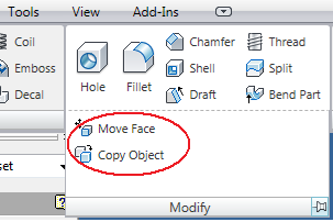

Property that returns the CommandControls collection object that provides access to all controls in the slideout section of the panel.
