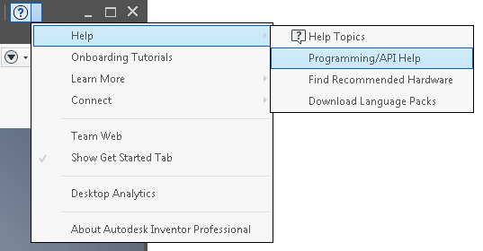

The API Help is installed with Inventor and is accessed from the Help menu as shown below.
The help content consists of several parts:
