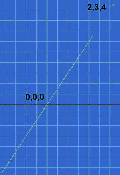

The following code creates a WorkAxis and adds it to the WorkAxes collection. The AddByTwoPoints method is used, so another WorkPoint is defined with X Y Z values of 0, 0, 0. So the WorkAxis will be defined by two points; the previously created WorkPoint at 2, 3, 4, and a new one at 0, 0, 0.
Dim oWorkPoint2 As WorkPoint Set oPnt = oTrans.CreatePoint(0, 0, 0) Set oWorkPoint2 = oPartCompDef.WorkPoints.AddFixed(oPnt, False) Dim oWorkAxis As WorkAxis Set oWorkAxis = oPartCompDef.WorkAxes.AddByTwoPoints(oWorkPoint1, oWorkPoint2, False) |
The AddByTwoPoints method creates the WorkAxis and adds it to the WorkAxes collection. Note the third argument again indicates that the newly created work feature should not be considered application-specific construction geometry. It is displayed on screen, appearing something like this:
