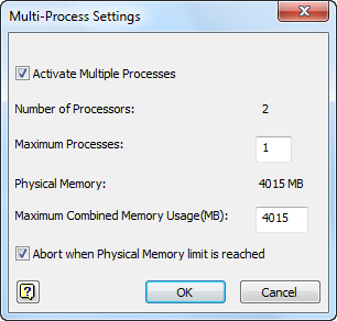

- Task Scheduler support multiple processes to shorten migration time. In the Settings menu, click Multiple Processess… button to open Multi-Process Settings dialog, See figure 1.
Figure 1

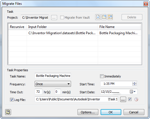

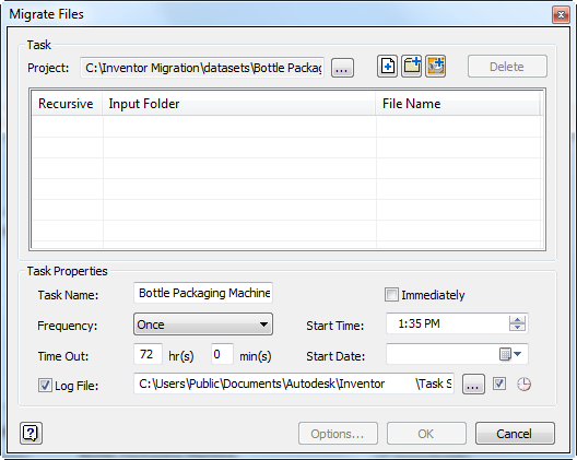

- The Task Scheduler window is displayed. Select Migrate Files… from the Create Task pull-down menu to access the Migrate Files sub dialog box. Click the Add Project tool button at the far right as shown in Figure 3.
Figure 3
- Each of your defined projects appears in the Project Settings dialog box. Double-clicking the project name you wish to migrate sets it current. You can click [Browse...] button in Project Settings dialog to select your specified project. Click the OK button when you are finished.
- The Migrate Files dialog box displays the selected project folder and project file name. See Figure 4.

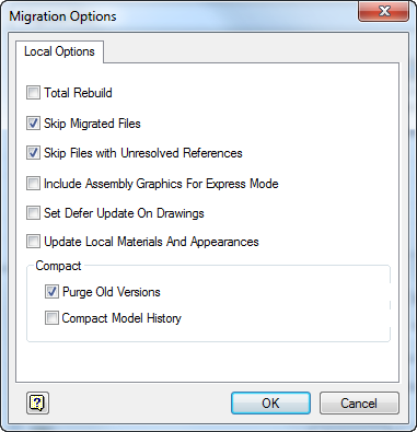

- There are several options that can be set that apply to all files being migrated. These options are accessed by clicking the Options… button at the bottom of the Migrate Files dialog box. This action displays the Migration Options dialog box shown in Figure 5.
Figure 5
- Each of the migration options are described as follows:
- Total Rebuild: Select this option to improve feature edit performance. This option causes part files (ipt) to be rebuilt using the Rebuild All command within Autodesk Inventor. Total rebuild is usually not used, but if the data being migrated is from a much older release (prior to R5.3), its use is recommended.
- Skip Migrated Files: Active by default, this option ensures that any files already up to date will be skipped by the utility.
- Skip Files with Unresolved References: Also active by default, this option controls how Task Scheduler responds when a file with unresolved references is encountered. This option automatically skips an unresolved file. When inactive, processing stops and the user is given the choice to skip the file or stop the migration process.
- Set Defer Updates (Drawings only): This option controls the defer update setting in a drawing file. The defer update setting keeps a drawing file in a static state. Selecting this option enables the defer update setting and migrates drawing files in a defer update state.
- Purge Old Versions: Active by default, this option keeps file sizes to a minimum by deleting the former versions of the migrated file after Task Scheduler finishes. (Be sure you have a backup of all the versions of the files you need.)
- Compact Model History: Do not select this option when migrating files to a new release because it purges rollback history used for fast feature editing. It should be used only if you are working with extremely large assemblies and experience capacity limitations.

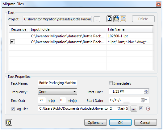

As previously mentioned, if you do not wish to migrate your Inventor files by project you may instead select specific files or all files in a directory including sub-folders. These options are accessed by clicking the appropriate tool button in the Migrate Files dialog box and are described as follows:

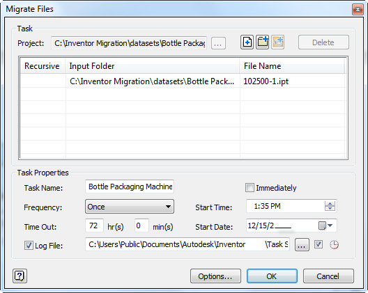

- Add files: Selecting this button displays a browser where you can select one or more files to migrate. This is a handy option to use when you wish to quickly migrate a small number of files such as your customized Inventor templates. See Figure 6.
Figure 6
- Add folder: Select this button if you store your files on a single drive under a single top-level folder (perhaps, with subfolders). All files in the directory will migrate in the proper order. the order is part, assembly, drawing. See Figure 7.
Figure 7
