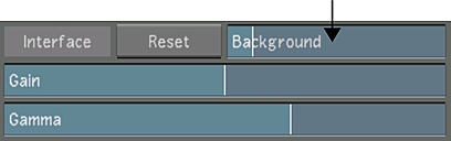

  2. In the Main menu, click Setup, and then click Interface to display the Interface menu.
  3. Set Background to the default value of 30.
    A value of 30 creates a subtle contrast between the background colour and the black frame.

  3. In the Main menu, click Setup, and then click Interface to display the Interface menu.
  4. Set Background to the default value of 30.
    A value of 30 creates a good contrast between the background colour and the white frame.
