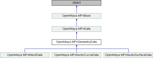

Inheritance diagram for OpenMaya.MFnGeometryData:Public Member Functions | |

Public Member Functions inherited from OpenMaya.MFnData | |
| def | __init__ () |
Public Member Functions inherited from OpenMaya.MFnBase | |
| def | __init__ () |
| def | hasObj () |
| def | object () |
| def | setObject () |
| def | type () |
Static Public Member Functions | |
| def | __new__ () |
Static Public Member Functions inherited from OpenMaya.MFnData | |
| def | __new__ () |
Static Public Member Functions inherited from OpenMaya.MFnBase | |
| def | __new__ () |
