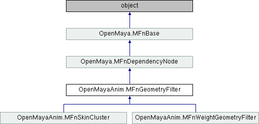

Inheritance diagram for OpenMayaAnim.MFnGeometryFilter:Static Public Member Functions | |

Function set for operating on geometryFilter nodes. geometryFilter is the abstract node type from which all deformer node types derive. __init__() Initializes a new, empty MFnGeometryFilter functionset. __init__(MObject) Initializes a new MFnGeometryFilter functionset and attaches it to a geometryFilter node. Method resolution order: - MFnGeometryFilter - OpenMaya.MFnDependencyNode - OpenMaya.MFnBase - builtins.object
