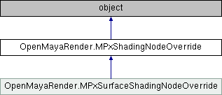

Inheritance diagram for OpenMayaRender.MPxShadingNodeOverride:Public Member Functions | |
