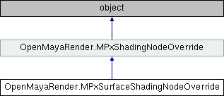

Inheritance diagram for OpenMayaRender.MPxSurfaceShadingNodeOverride:Public Member Functions | |

Base class for user defined surface shading node overrides. Method resolution order: - MPxSurfaceShadingNodeOverride - MPxShadingNodeOverride - builtins.object
