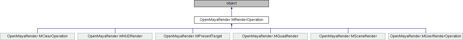

+ Inheritance diagram for OpenMayaRender.MRenderOperation:
