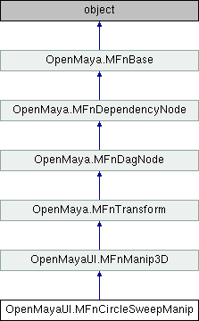

+ Inheritance diagram for OpenMayaUI.MFnCircleSweepManip:

Method resolution order:
-   MFnCircleSweepManip
-   MFnManip3D
-   OpenMaya.MFnTransform
-   OpenMaya.MFnDagNode
-   OpenMaya.MFnDependencyNode
-   OpenMaya.MFnBase
-   builtins.object
