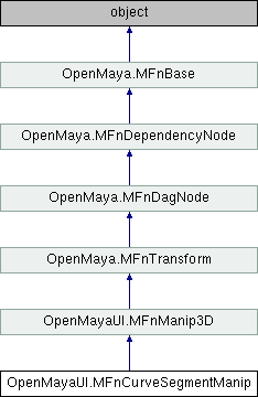

OpenMayaUI.MFnCurveSegmentManip Class Reference
+ Inheritance diagram for OpenMayaUI.MFnCurveSegmentManip:
