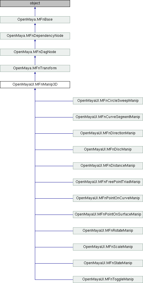

+ Inheritance diagram for OpenMayaUI.MFnManip3D:

Detailed Description
MFnManip3D allows the creation and manipulation of 3D manipulators.
Method resolution order:
-   MFnManip3D
-   OpenMaya.MFnTransform
-   OpenMaya.MFnDagNode
-   OpenMaya.MFnDependencyNode
-   OpenMaya.MFnBase
-   builtins.object
