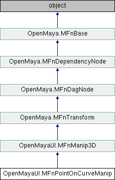

+ Inheritance diagram for OpenMayaUI.MFnPointOnCurveManip:
