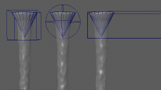

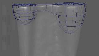

Turn an emitter off or on gradually using its boundary
You can activate and animate an emitter's boundary to turn it off or on gradually. This method can be useful in particular cases, such as when the emitter mesh needs to be rendered or if you do not get the desired results by scaling the emitter mesh.
  1. Select the bifrostEmitterProps node and display its emitterProps tab in the Attribute Editor.
  2. In the Boundary Controls group, turn on Enable.
    The default shape is a box with sides of length 2, displayed as a wireframe in the viewport.
  3. Select a different Boundary Shape if desired, and then scale, rotate, and translate the bifrostEmitterProps node to enclose all or part of the emitter's geometry.
    The fluid gets emitted in the intersection of the boundary and the emitter's geometry.
  4. Animate the bifrostEmitterProps node's transformations to increase or decrease the volume of the intersection.
