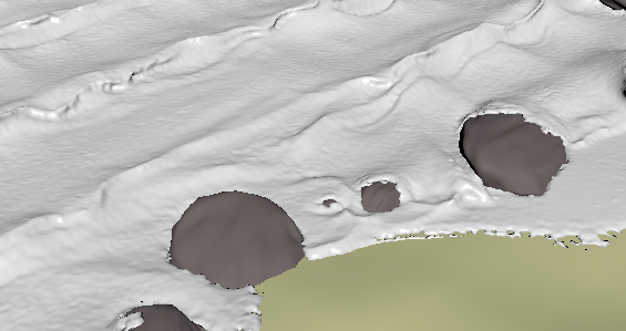

View the liquid surface
  1. In the liquid shape's Display attribute group, turn on Voxels.
  2. Optionally, turn off Particles.
  3. In the Voxel Display attribute group, turn on Diagnostic Color.

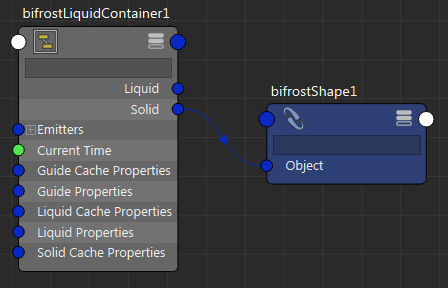

View the collider or guide surface
  1. Display the main container node in the Node Editor.
    For more information about working in the Node Editor in general, see Use the Node Editor to create node networks.
  2. Add a bifrostShape node to the graph.
  3. Connect the container's Solid (for colliders) or Guide output to the shape's Object input.
  4. In the shape's Display attribute group, turn on Voxels.
  5. Optionally, assign the shape a shader of your choice.
