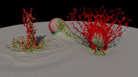

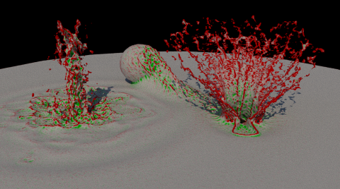

Ocean Blending
These attributes perform a simple blend of the fluid surface with a planar mesh. They can be used for oceans, for example, if you are using a Bifrost simulation for waves and splashes in a specific region, and a mesh for the rest of the ocean surface.
For best results, use a flat planar mesh and a displacement shader such as a vector displacement map generated by BOSS. A deformed mesh can give acceptable results as well, as long as the displacement is not too large (in other words, calm water rather than rough seas). In either case, depressions in the simulated surface might get filled if liquid can flow in from the surrounding ocean.
Enable
Enables ocean blending.
Mesh Plane
The mesh to blend with the Bifrost shape.
Boundary Radius
The radius of the blending region around the intersection of the simulation and mesh surfaces.
Offsets
The Y offset can be used to raise or lower the mesh plane to provide a better blend. The X and Z offsets can be used to adjust the plane's horizontal extent: use positive values to expand it or negative values to shrink it.
Output Channel
The name of a custom channel to use as a mask when displacing the blended mesh. If you are blending with a flat mesh using displacement, make sure to add this channel to the Export Channels list and then use the channel to control the amount of displacement.

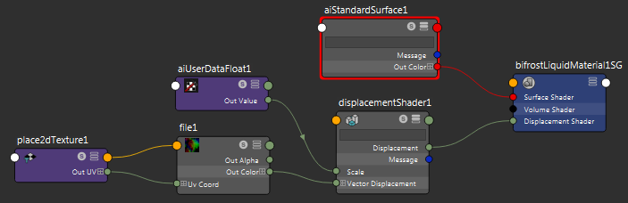

To blend with a flat mesh using displacement:
  1. Specify the flat plane for which the displacement map was created as the Mesh Plane.
  2. Specify the name of the Output Channel to use for blending. The default is ocean.
  3. Add the same channel name to the Export Channels list.
  4. In the Hypershade window, add a displacement shader to the liquid material. For more information about working in the Hypershade window in general, see Hypershade window.
  5. Connect a File texture node to the displacement shader's Vector Displacement attribute.
  6. Specify the displacement map in the File node's Image Name attribute.
  7. Use a utility shader to get the Output Channel you specified (for example, ocean) and connect it to the displacement shader's Scale attribute. The name of the shader and the procedure for this step depend on your renderer.
  8. Adjust the Boundary Radius and Offsets to control the blend.
