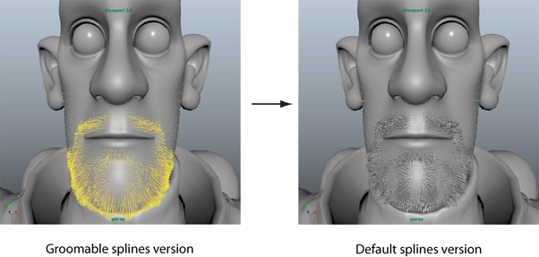

In this part of the example, you preview the default spline version of your groom. You can switch back to the grooming brushes at anytime and continue grooming with them.
This turns off the display of groomable splines, which improves XGen performance while you work with the default splines.
The default splines display in the areas you populated with groomable splines.

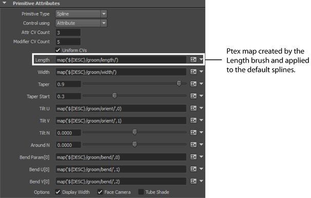

Notice that for many attributes, a map file path displays instead of numeric values. This indicates that the attributes are controlled by Ptex maps. These maps are created and updated when you paint with the Grooming brushes.
You may need to further edit the splines to generate the desired look for the character's beard. For example, you can add taper or color to the splines.

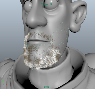

Notice that a Ptex map defines the Primitive Color attribute. You can instead use an expression to generate a color swatch and select a color for the beard.
to open the
XGen Expression Editor.
A color swatch appears beside Primitive Color.
The Primitive Color you set does not appear in the rendered Description. To specify a color for the splines in the rendered output, you must modify the XGen hair shader (see Set color values of the XGen hair shader).
Continue working with the Grooming brushes and the default spline attributes to achieve the desired look. Render your Description using your desired renderer. See Shading and Rendering XGen Primitives.
