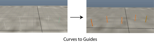

Converts curves back to guides so you can continue to shape and edit them. You can use Guides to Curves after editing the Guides.
Displays the names of the Description being edited.
Sets the amount the guide stretches to reach the tip of the curve.
Controls how closely guides follow the curve shape starting from the base to the tip.
Lets you add guides based on their relationship to the curves.
Curves are selected using the Search Type results, which determines where the guides are added.
Selects curves that have their bases close to the location of guides.
Selects curves that have names associated with the guides, and then adds the guides to the surface.
Selecting Name Association disables TipSnapAmount and Delete Curves.
Deletes the selected curves after they are converted to guides.
Turn on Preserve Dynamic Link when driving guide shape and animation using nHair dynamic output curves. See Animate guides using nHair.
