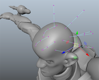

-select all the guides.
to select the Guides As Curves utility.
This utility lets you shape the guides as NURBS curves.
A temporary NURBS curve is created for each guide.
If this happens, click Accept to save the curves you have already modified. Select the guides you still want to shape, and then click Modify As Curves.
After shaping the guides, locate and expand the xgCurveFromGuide group in the Outliner and select all the _tempCurves objects.
Maya applies the curve shapes to the guides and deletes the temporary curves.
-clicking a guide, and then selecting
Guide Control Points from the menu that appears.
to mirror their position and shape to the opposite side of the mesh.

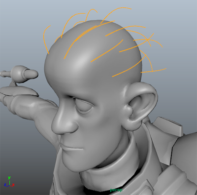

to view the generated splines.
Notice that the splines cover the scalp region, but are spread too thin. Increase the Density attribute to add more splines per-face and preview the Description again.
