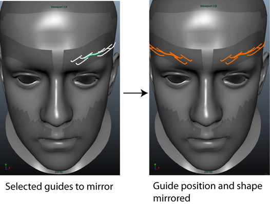

You can use the Mirror Guide tool to mirror guide position and shape across the X-axis of your polygon mesh. Use this to generate two areas of primitives that are symmetrical, such as eyebrows and hair grooms.
 icon.
 icon. XGen adds new guides at positions and with shapes that mirror the selected guides.
