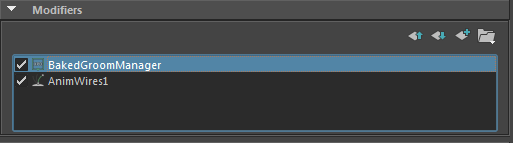

An Anim Wires modifier is added to your Description's modifier stack.

Maya generates the points map for the animation wires. You can now generate output curves and attach the nHair system (see below).
If your Descriptions have one or more Clumping modifiers, you must specify a control map for the Anim Wires Modifier modifier.
For example replace Clumping2 with Clumping1.
