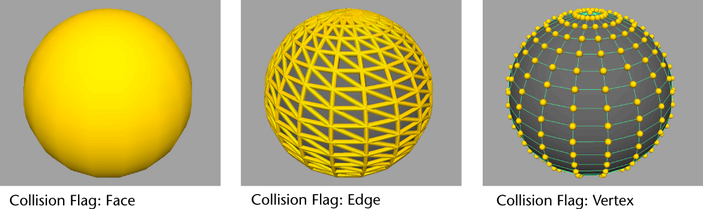

Specifies which of the current nCloth object’s components participate in its collisions.
The current nCloth object’s vertices collide. Collisions occur at the collision spheres that surround each of the nCloth’s vertices.
The current nCloth object’s edges collide. Collisions occur at the collision cylinders that surround each of the nCloth’s edges.
The current nCloth object’s faces collide. Collisions occur at the collision surface that is offset from the nCloth’s faces. Note that when the nCloth’s Thickness value is greater than 0.0, its face collisions are the sum of its vertex, edge, and face collisions. This extends and rounds the borders of the collision surface.

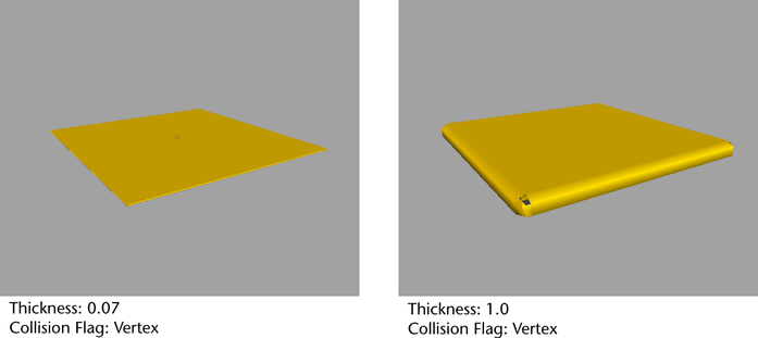

Specifies the radius or depth of the current nCloth object’s collision volumes. nCloth collision volumes are non-renderable surfaces offset from an nCloth’s vertices, edges, and faces that the Maya Nucleus solver uses when calculating self-collisions or passive object collisions.
Collisions occur at an nCloth’s collision volumes, not at the surface of the nCloth object itself. The following collision volumes are used by nCloth: collision spheres for vertex collisions, collision cylinders for edge collisions, and collision planes for face collisions. Each collision volume on an nCloth has the same radius or depth unless overridden by a Thickness Map.
Thickness also determines how thick your nCloth appears.
For example, a value of 0.0 creates thin nCloth (such as silk) and a value of 1.0 creates thick nCloth (such as felt).

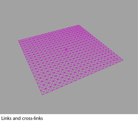

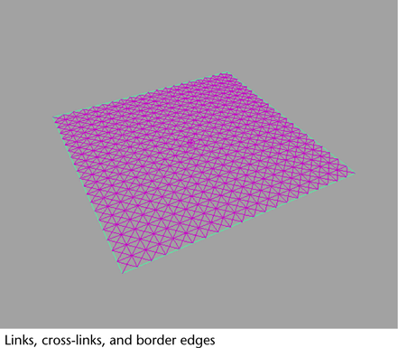

The nCloth’s stretch links are displayed in the scene view.
The nCloth’s bend links that are used to calculate bending in the nCloth are highlighted in the scene view.
